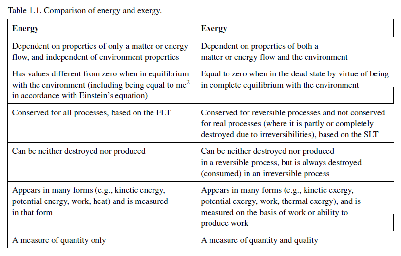

M!Zare 48040 مالک ارسال شده در 17 شهریور، 2012 The exergy method of analysis overcomes the limitations of the FLT. The concept of exergy is based on both the FLT and the SLT. Exergy analysis clearly indicates the locations of energy degradation in a process and can therefore lead to improved operation or technology. Exergy analysis can also quantify the quality of heat in a waste stream. A main aim of exergy analysis is to identify meaningful (exergy) efficiencies and the causes and true magnitudes of exergy losses. Table 1.1 presents a general comparison of energy and exergy 5
