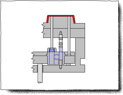

Ejector Pins & Sleeves
This animation shows a typical method to eject the cooled part from the mold. Round ejector pins are used to force the molded part out of the open mold. In this unit you will learn about ejector pin types, their application, and actuation.
Ejector Systems
This animation shows a Pin Type Accelerated Ejector. Accelerated ejectors help to eject molded parts that tend to stick to a core, causing a normal ejector pin set-up to damage and/or stress the ejected article. This unit will cover a few of the typical ejection systems.

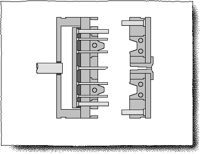

Mold Plate Control
The animation shown uses an external Latch Lock System to control stripper plate opening. The mold parting line is allowed to open to a set amount, then the stripper plate is locked while the mold continues to open. Controlling plate action can shorten cycle time and increase production.

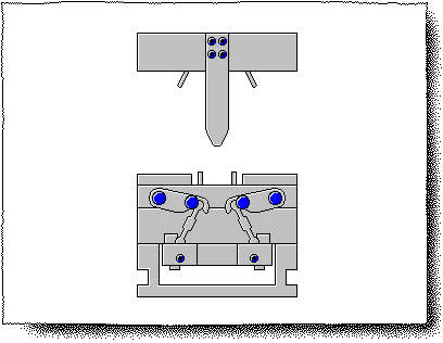

Early Return Systems
This animation shows a Toggle-Lock System for early ejector assembly return. The ejector pins must be returned before the cam pins contact and move the slide blocks in, or mold damage will occur. This unit will also cover an internal early return system

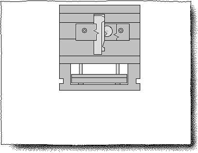

Molding Part Geometry
This animation shows a system used to mold an undercut and then release it during part ejection. Special mold designs and systems are required to eject undercuts or restrictions. This unit will cover some typical methods used.
